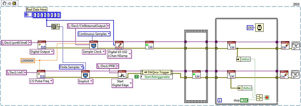

The LabVIEW code would look something like this (I attached it at the bottom of this post for convenience--please excuse the lack of a front panel):
To summarize the code, the basic idea is that:
    1.  The DO Task is armed first, but won't do anything until it receives the clock from the counter output
    2.  The Counter Task is then armed, and is waiting for the trigger signal
    3.  Once the trigger comes, the CO outputs a finite number of pulses (the number of DO Samples that need to be generated).  Each pulse corresponds to one DO sample.
    4.  When the task is finished, the counter is re-armed.  Since the DO Task is set to Continuous and has finished generating its buffer, the "write pointer" will loop back to the first sample in the buffer.
    5.  On the next edge of your trigger, repeat step 3 (until the stop button is pushed).

Hi, John --
First of all, thanks for replying to my post so quickly!  That was great!
I finally got a chance to try your VI to see if it would work, but, after reconfiguring the inputs for the tasks to suit our system here, I'm still getting that *&#@! 201062 error ("Selected lines do not support buffered operations.") when I try to run it.  I'm attaching the altered version of your VI so you can see how I have the inputs configured.  I guess my main quandry at this point is whether there are buffered and unbuffered lines on the PCI-6259 board or if maybe I'm missing something that a nonignorant person would see right off the bat.

I'm still having trouble getting that VI running, and I have a feeling that it has something to do with that DAQmx Trigger.  While we're working on getting a usable version of this VI going, we're using a push button to simulate the triggering pulse.  I tried doing that before in a slightly different context (but still using the DAQmx Trigger) a while back and ran into problems then, too.  I eventually ended up using a modified version of the "Gen Event for Ext Signal.vi" from the Example finder (Hardware Input and Output>DAQmx>Events), which is obviously a little more cumbersome, but it works like a charm.  Is there something inherent in a push button's output that the hardware/software combination doesn't like?  We have it hooked up to PFI 7 and the VI is looking at PFI 7 for a signal, but for some reason it looks like the DAQmx Trigger (configured as Start Digital Edge) isn't recognizing it.  There are no error messages associated with it; it just acts as though nothing happened when we push the button.

Which line on port 0 are you outputting the signal on?  Digital is kind of funny.  If you're writing U32 (which the example is), then the first bit of your number would correspond to line 0, the second bit with line 1, and so forth. For example:
[1 ... 1]  would set line 0 high
[2 ... 2]  would set line 1 high
[3 ... 3]  would set line 0 and 1 high
[4 ... 4]  would set line 2 high
[5 ... 5] would set the line 2 and 0 high
etc.
The driver masks out any lines that aren't included in your task.  So, if you're on p0.x, the U32 that you should write to your task to set this line high should be 2^x.
Could this be what you're seeing?  If this doesn't help could you post the code with the lines selected that you intend to be using?

Hi, John --
That did it!  I guess I had a vapor lock about the U32 signal vs. what I thought was happening.  I changed the DAQmx Write input to a digital waveform, and BINGO!  It looks great on the scope.  I think we're good to go now!  Thanks a zillion for being so patient with the ignoramus here at the other end of the forum.  Not only does the VI work, but I learned tons in the process.  Hard to beat that.
