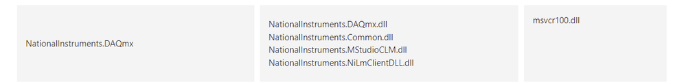

Few things to clarify,
  1. Even though the article talks about Measurement Studio, it is the same for C#/.NET development - do you have a concern why you don't want to follow the same process to install the required libraries?
  2. You need other dependency DLLs to get the DAQmx DLLs to work as described in this article - https://www.ni.com/en-us/support/documentation/supplemental/14/ni--net-assemblies-needed-to-deploy-a...

I can't find
NationalInstruments.MStudioCLM.dll
NationalInstruments.NiLmClientDLL.dll
