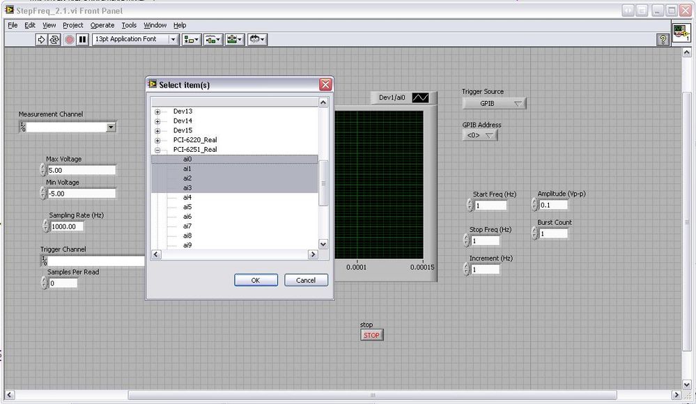

Hi Glen,
You are seeing Error -50103 because you have two AI tasks running at the same time. For causes of the -50103 error, please read the Knowledgebase linked here.  The reason you can't run two AI tasks at the same time is because your M Series DAQ cards only have one AI timing engine.  You must stop and clear your first AI task before you can start your next AI task. You can add multiple channels to a single AI task by selecting Browse from the drop-down menu of your channel selector control then holding shift while you select multiple channels as seen below.
