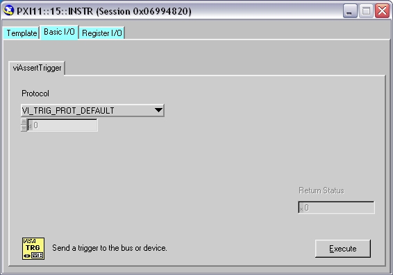

I don't see a Reset or Self-Test button in MAX. The VISA Test Panel has the following tabs:

Also, in the MAX VISA Test Panel, if I click the "Execute" button for a viGetAttribute value, neither of the device's front-panel LEDs lights up. I assume that they should, but I'm unsure.
