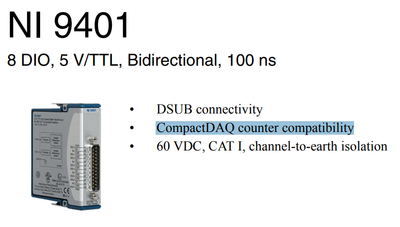

I concluded that it must have some peripheral due to this information in the datasheet:

It only means that the module is compatible with counters on a Compact DAQ Chassis, older chassis have only 2 counters newer chassis come with 4 counters and you can route the digital lines form the NI 94XX to any of those counters.
