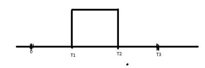

I have the attached VI which I would like to have a help with to bring it to the working state to fulfill my requirements. Correct me if I am wrong, but I understand the VI to work in the way that using the counter output pulse as a guide/condition so that as long as the task of generating the pulse out of the 'CO Pulse Time' VI is going on or there is no error during this task, to write the boolean value to the output line. So I'd like to use this same manner such that I would be able to write to the digital output line but during the high time of the pulse.
My understanding: Initial delay is 0 up to T1
                            High time is T1 up to T2
                            Low time is T2 up to  T3
I would appreciate if anyone helps me to the right direction if I am off track and I would like to send the Boolean HIGH to the digital output line only during the high time of the pulse from the Counter Output.

One quick question: During this case what is the pulse duration? Is it T3 - T1 or all the way from 0 to T3?
Message 7 of 24
