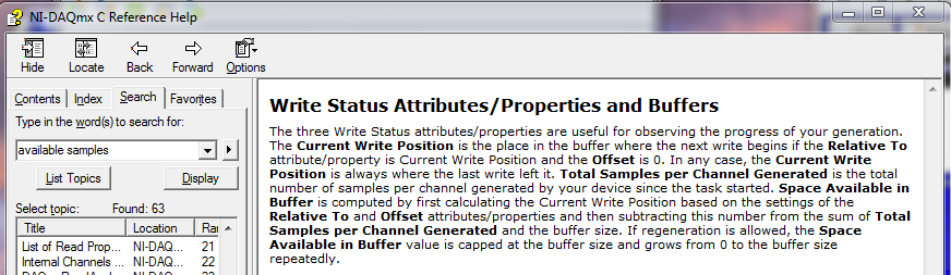

The same options are available for writing operations, take a look at the picture. I could not find the examples but this options should give you a starting point.
