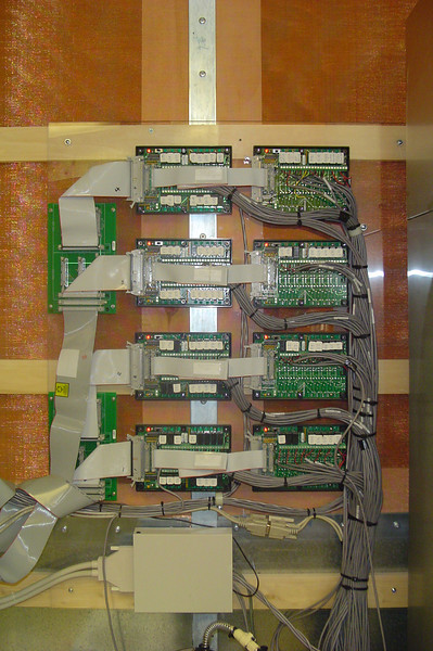

Not without some signal conditioning.
NI makes a relay board kit that you can connect to a power supply capable of the power required, then connect your devices to the relay block.
http://sine.ni.com/nips/cds/view/p/lang/en/nid/10689
(We had all those relays controlled by a couple of PXI Digital I/O boards.)
