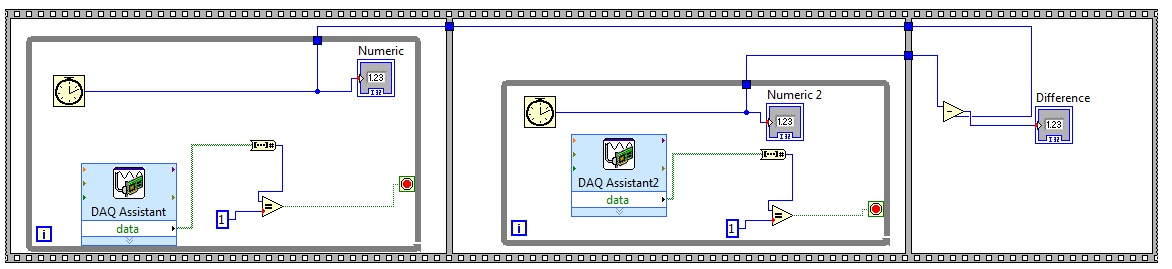

I'm new to labview, and I have two signals both 5 volts. One occurs first and then the other one. I was trying to use true/false condition and converting data output of DAQ assistant into boolean and running a timer and then substracting two times. But I get really small time difference of 10ms, however its true values lies around 400 - 500ms. If you will give any suggestions please explain what the block codes do. Thanks.

It might be a simple fix, but I am not sure how you have set up the code.  Posting the code or a screenshot of the block diagram would be helpful.

The only thing I am not sure is how much delay is introduced by the labview code to actual time difference between two signals.

Unfortunately the 6501 doesn't have a lot of timing/triggering capabilities like the more expensive DIO/mixed-signal DAQs do.  The 621x series might be a better option, or one of the X-series modules.  Downside is $$$...
Rather than using the DAQ Assistant, use the DAQmx Create Channel VI (Digital Input polymorphic) and wire in DevX/Port0/Line0:1 (if you're using P0.0 and P0.1 as the two DI lines) to "lines", and "one channel for each line" in line grouping.
Use the ... blah, take a look at the attached example.  Add some logic where the data indicator is.  This example stops when both lines go high (both lines connected to gnd).
I'd recommend using the "get date/time in seconds" VI when the first line goes high, take that value and subtract it from anohter "get date/time in seconds" reading when the second line goes high.
If your application requires a little more precision (like, sub-millisecond resolution) I'd suggest a better DIO... but if a few msec error is acceptable, polling the DI lines and software-timing is probably the cheapest route.
