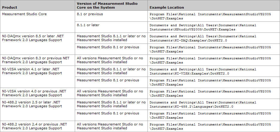

It sounds like you are relatively new to programming with the NI-DAQmx API.  I think the best option for you would be to refer to some of the shipping examples that are included with the driver when you choose the option to include support for .NET.  This would allow you to see a testing and working example similar to the application that you are trying to implement.  It will allow you to see the proper programming flow for setting up various types of applications.  The examples for VB.NET are located in the directories shown in the following image:

Thank for your reply and the table of sample code location ( seems it is the same as in the documentation ) it is a good sample but still in a piece by piece code. If each of them function independently when we include all of them into the same project seem to be OK . My worry is if all tasks has the lifecycle time of the application lifecycle in another words there is no task was disposed during application running , would it be any system resource issue?
