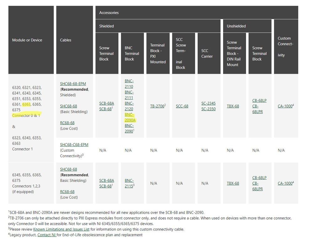

As per this link, BNC2090A is supported for 6363 both connectors
