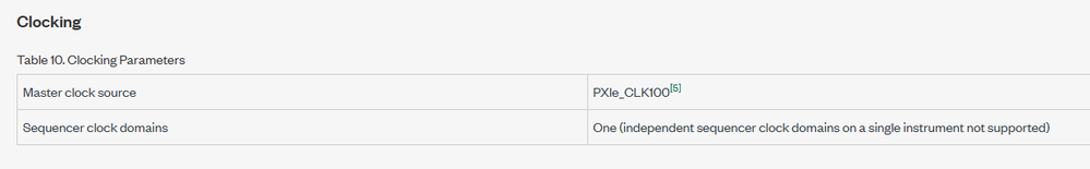

What is the rationale for this request? it is not a clock source to state these parameters, it is a digital pattern instrument.
It uses the PXIe-100MHz from the chassis and hence you need to refer the chassis's clock source for jitter.

Hi Santo,
Please refer the below link
https://knowledge.ni.com/KnowledgeArticleDetails?id=kA0VU00000039LJ0AY&l=en-IN
i was expecting a solution like this.
below is the scope shot for 100MHz from PXIE-6570 instrument ,there you can see the jitter results but not sure whether it is comply with the actual response of PXIE-6570
