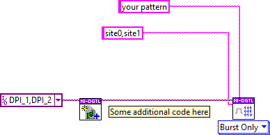

If you're using Digital 19 or higher (may be from 18 too I'm not sure), there is a feature called instrument group, you can do this by passing the instrument names as a list in the initialize, now all instruments are part of the same session.
With this feature, your code simplifies as below.
Edit: regarding your last question, yes, settings are retained per instrument, if you have got an array of sessions, operations on respective sessions affect only those instruments, when you use the instrument group feature, depending on the settings it will be applied to the listed site or all instruments.

Due to some framework limitations, I can't go with the first option. So I wanted to make things work with a single reference.
It seems, Second option works. I will try it with the latest DPI version.
