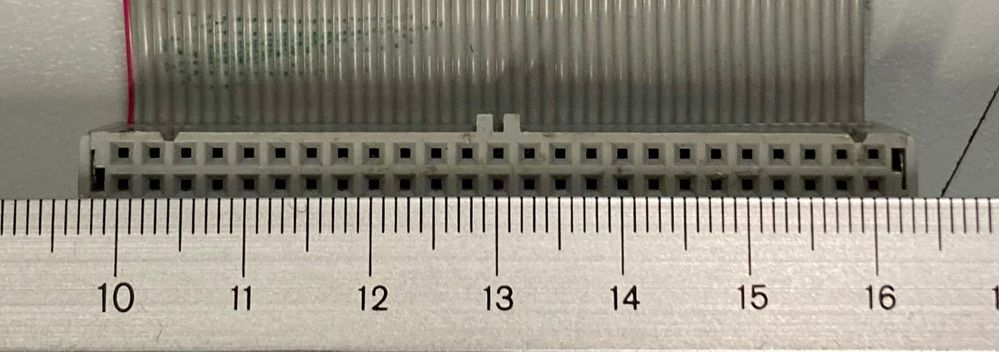

Having such connectors at my disposal, I've just taken a photo. The scale is in [mm].
Message 7 of 8
(3,722 Views)
That means 2.54mm pitch, thank you for your help!
