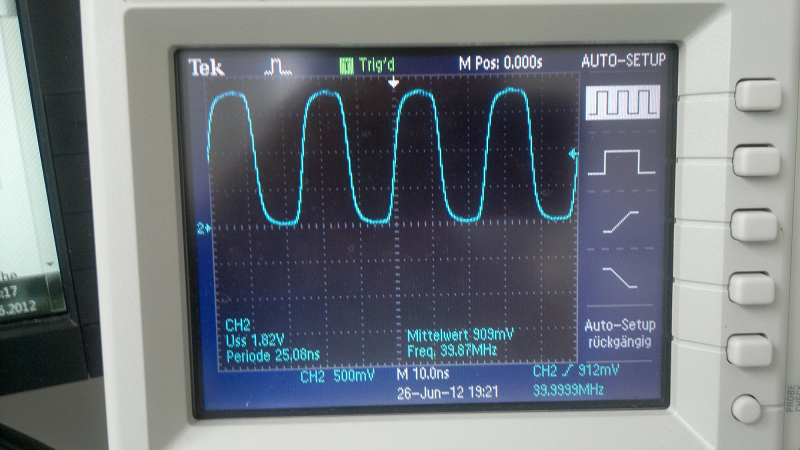

hi everyone,
I was experimenting with DDC CLK OUT signal. 40Mhz 1,8Vpp looks good. But when I put a capacitor 22pF parallel between pin DDC CLK OUT and GND, I got very low signal, about 1Vpp only. I mean, using 2m cable would have unwanted capacitance also, right? Would this be the same case when I generating my digital signal with 6544? I've taken a picture using my phone, but can't upload it properly. I'll try to upload it later.

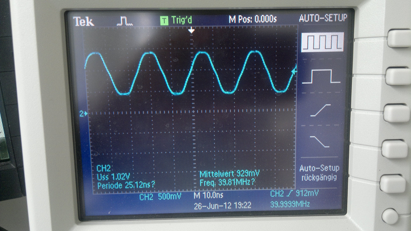

hi,
this is the photos.
regards,
Yan.
Message 17 of 18
(2,550 Views)
Hi Yan,
you are building an RC circuit and this always has a little voltage drop, normally the drop is round about 0,1 V
with your settings. You can calculate the voltage drop with this formula
And yes the circuits on our card have similar designes for digital lines and for the clock so it could happend you
can see the same behaviour on other lines.
best regards
Alexander
