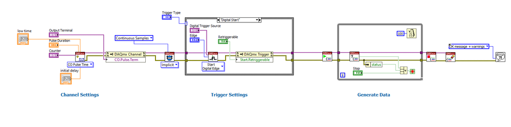

However, I am really puzzled. My vi fails. The only difference being I have a sample clock defined. I am posting again my vi which is slightly edited version of the one I replied to Santosh.
So if I run 6218, I do not have initial delay true or false condition because I force it to be false. And then I have the timing module which as I argued before is perhaps not needed because trigger is doing all the job (being a re-triggerable event)
Which is why I was forced to use implicit timing because otherwise my vi does not even run.
However, with my vi, the trigger signal and counter signal run wild relative to each other and approximately synchronize under very special values for pulse width. Beats me!
I could post a video but I hope I am clear:
counter moves w.r.t trigger in my example
In Kevin's both are rock steady fixed relative to each other
Can someone please explain what is going on? My suspicion is that by incorporating a timing module I am forcing the re-triggerable event to be w.r.t internal clock. When i try to set an external clock it throws an error.

I decided to instead put a picture of my vi. And also saved it as 2018 version.
Hope this picture or the new uploaded file works for you.
Message 15 of 16
(1,278 Views)
Accepted by topic author gujax23
It's kinda subtle and not particularly obvious, but...
Declaring a *continuous sampling* task implies that you want to produce your own never-ending stream of pulses in reaction to just one triggering pulse.  Once that single trigger arrives, your pulses run on their own according to your initial timing parameters.  If they don't happen to match the timing for the incoming pulses (and they almost certainly *won't* match exactly), you won't *stay* in sync.
My method never calls DAQmx Timing and therefore generates only 1 pulse per input trigger.  Making it "retriggerable" is the thing that makes it keep generating pulses.  It pulses once per trigger, so as long as the triggering pulses keep coming, you'll keep generating additional output pulses.
-Kevin P
Message 16 of 16
(1,267 Views)
