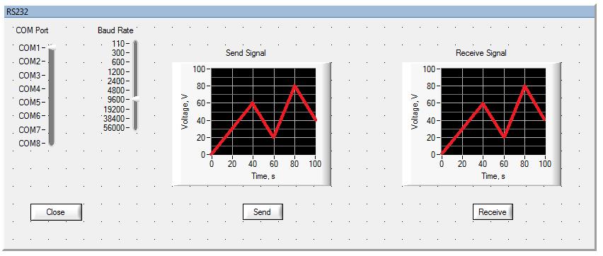

I will make this. This is my simple in .*uir file, but how programing this in *.c?
Please, help me 😞

thanks 🙂
But how  write graph variables to array:?
Message 7 of 8
(4,482 Views)
You will write the graph data as a numeric array and then on the receiver side you will plot it again.
