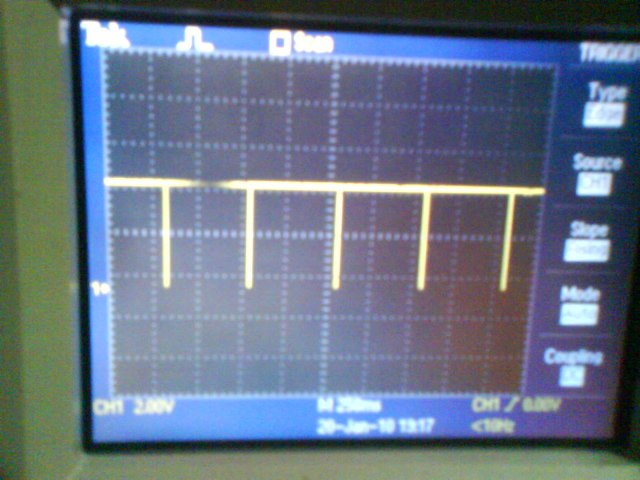

I have the following signal at the entry of my module 9401.
Zoomed it is like that :
So the lengh of the pusle is very short (1,5 ms)
I am able to count it using a counter and simple edge counting for instance.

So, my point is : I'm not able to work with this signal using a digital input. I mean if you invert this signal and link it to a indicator like a LED, the LED never blink.
I did a test to know if it was my .vi the culprit.
I tried my .vi with a function generator, generating pulse like that but much longer (a 5V PWM with a duty cycle of 50%, instead of 0,003 % like here) and it works.
Do you know if it is because the duration of the pulse is too short it doesn't work ?
