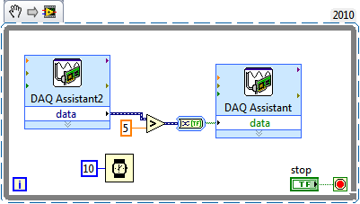

Hi newbee22,
The simplest use case if you want to use DAQ Assistants might look something like this:
        21898i8D47DA1A673974C7
The above code uses software-timing to achieve the feedback, which is going to create some latency (on the order of ms) and non-determinism.
If you want to improve upon this, the 9205 does have an on-board comaprator on it (for analog triggering) that you should be able to route to the 9402 without having to go through software.  If low latency and determinism are important to your application, I can offer more advice on how to set this up.  You would have to use the lower-level DAQmx API rather than the DAQ Assistant to program this.

John,
thanks for your help. I tried the wiring you suggested, but the 9402 isn't outputing any signal. I have the Generation Mode set to 1 Sample(on demand), all the other options are grayed out. When I click on the DigitalOut button while inside the DAQ Assistant, I can see the output go high or low, but the logic feeding the True/False from the 9205 doesn't seem to be triggering the same response. (I don't have the Line inverted...)
Any ideas? Thanks again.

John,
here it is. Pretty much what you suggested. DAQ Assistant 2 is the 9402. The idea is to get the line0 on the 9402 to go high if one of the values read in the 9205 is above the theshold. NOt sure what I'm missing.. thanks

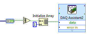

Hi newbee22,
Oh sorry about that, the DAQ Assistant is actually looking for a 1D array of booleans (the same DAQ Assistant can work for multiple DO lines).  If you just convert the result into a 1D array of length 1 it should work out.  Something like this:
21938i254B8D702B35C5A1
Best Regards,
John Passiak
Message 8 of 9
(4,541 Views)
That did it John, thanks for your help.
