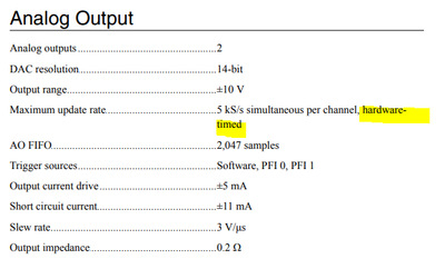

USB-6001 Specifications
Surprisingly, USB-6001 actually supports hardware-timed output.
