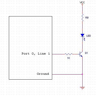

Argon,
Now that I see the full part number of your current sink, I better understand what it does but am now more confused as to what you are trying to accomplish.  Do you want to control individual LEDs with the 6501 directly or do you want to control them through the STP16CP05?  If you want to do it directly, refer to my attached schematic and copy that circuit for each LED (you may need to adjust the 1K resistor value).  If you want to control them through the current sink, you will need to connect the LEDS to the current sink IC and follw the programming guide from the datasheet.  The STP16CP05 is a serial in/parallel out driver which will allow you to control the On/Off of 16 individual LEDs using only a couple of digital IO lines from the 6501.
