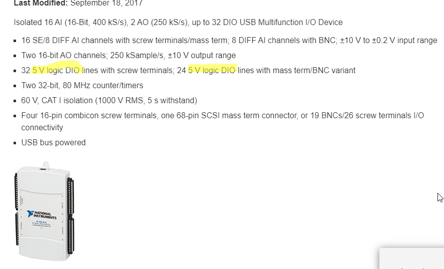

As you can see from the datasheet of the instrument, the DI/DO are fixed 5V logic level, you cannot modify the voltage levels. It is just that the digital front-end does not have the ability to configure voltage levels.
If you need a DIO with flexible voltage levels, you've to get an HSDIO 655x or Digital Pattern 657x.
You can use AO but you will lose the digital waveform ability and switch to analog waveform domain. If you still want to use a DIO with a flexible voltage level, you can add a voltage translator/buffer at outside the instrument to get the functionality.
