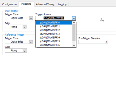

However when I try to create a Digital In task, and then connect a start Trigger, or Reference Trigger , the only options available are other Ports on the Module.
cDAQMod2 is the Digital Module NI9421, PFI0-PFI7 are ???? I think the ports on the board.
Whether it is the Sample Trigger or the Reference Trigger, I get the same options for cDAQ2Mod2/PFI0-7 as triggers.
