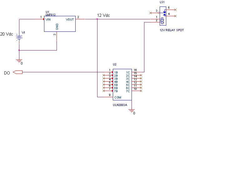

lets make this simple...just use a LM7812 with a ULN2003( which has 'flyback diode' protection built in)...
Spoiler
(6,984 Views)
Thank you for the answer! Interesting....
In this application, wouldn't I need a sinking DO? (Meaning that I would need the NI9477 isntead of the NI9476).
Also, what are the benefits of this application instead of my resistor? (Out of curiosity)
Thanks!
(6,974 Views)
Thanks!
yes, tie the gnds together with your Daq
benefits are your current load does not effect the regulated voltage, on the other hand..it would effect your resistor drop
