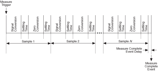

So it seems the PXI-4132 is the only device that does this auto-zeroing, and by default it is on! Here's more info on the behavior: PXI-4132 Auto Zero
If you are not changing the auto-zero property, then by default the property will be set to On, and this will be the behavior:
Auto Zero On
When auto zero is on, a zero conversion is performed after every sample conversion and subtracted to correct for measurement path offsets and drift. Use this option for the best accuracy measurements. After each signal conversion, the measurement path is switched to an internal short, followed by a settle time of ~600 µs which allows the analog circuitry to settle, then the zero conversion is taken (using the same aperture time as the signal measurement). After the zero conversion, the switch is changed back to sample the signal and settle time is used again before proceeding.
The following image illustrates a measurement acquired with number of samples to average set to N and auto zero on.
Note that the zero-conversion should use the same aperture time as the signal measurement, and that the N samples here refers to the Samples to average attribute, NOT the aperture time setting.
I still don't think this explains why you are getting such different results in each measurement range. However, you could try setting the auto zero to off see if things are more consistent.
If you're not changing the aperture time when changing current ranges, I wouldn't expect that to affect it. Any issues with the auto-zero should show up in ALL your measurements. It's also possible that the "internal short" created is different for different ranges.
