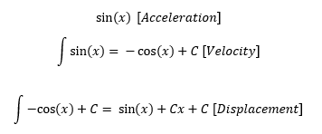

I checked your VI and that is the expected result. When you integrate an undefined function you will add a constant C to it and if you do it again besides adding another  C constant, the previous one will be multiplied by x (As you can see on the image below).
Considering the physics of it, when you have a sinusoidal acceleration it keeps oscillating between -1 and 1 thus causing it to accelerate and deaccelerate continuously. While the acceleration is positive the velocity increases and when it is negative it decreases till zero. As there is no negative velocity, it keeps on moving forward continuously but varying its speed therefore generating the slopes observed on the displacement graph (the third one).
What do you think? Does it make sense?
