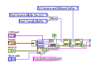

perso je suis pour le real... 🙂
je pense qu'il faut absoluement faire un mask 48 : VISA Set I/O Buffer function at the beginning of your application (after the VISA Open, before any reads or writes) and set the mask to 48
c'est pour cela que le code refonctionne
c'est le code de ton exemple N°2 qui est fonctionnel.
dans le code qui ne fnontionne pas, le N°1, tu ajoutes entre l'init port et la lecture des registres (donc les 2 vis modbus- juste après l'init), le mask 48 (donc juste avant de rentrer dans la boucle de lecture)
https://knowledge.ni.com/KnowledgeArticleDetails?id=kA00Z000000P6FmSAK&l=en-US
The problem comes from the VISA Write IRP_MJ_FLUSH_BUFFER request causing an INVALID DEVICE REQUEST response from the device. By default, each VISA Read and Write is followed by a VISA Flush call when communicating via RS-232. You can change the VISA Buffer setting to keep VISA from executing the flush call to avoid this error.
If you call the VISA Set I/O Buffer function at the beginning of your application (after the VISA Open, before any reads or writes) and set the mask to 48 (16 + 32, where 16 is the mask for receive buffer and 32 is the mask for transmit buffer) and the size to some value between 4k and the largest amount of data you ever expect to read or write, that will cause the flush command to not be executed.

tu as une erreur I/O que tu corriges via la configuration "I/O receive and transmit Buffer" mask 48
