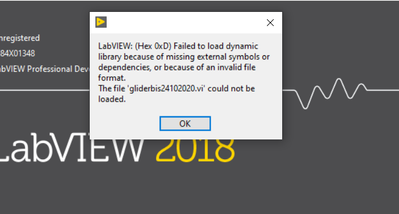

Bonjour , je n'arrive plus à ouvrir mon VI principale
 Comment peut-on le récupérer? Merci. Cordialement.

LabVIEW gives this error when a VI lacks the data necessary to open. The VI may have become corrupted and unrecoverable.
  • Try opening a backup copy of the VI
  • Try to open the file in other versions of LabVIEW or on another computer.
To prevent or mitigate this issue:
  • Make frequent backup copies of the VI
  • Save VIs in a local location instead of on a network
  • Uninstall and Reinstall LabVIEW.
If you receive this error when trying to deploy a built application (EXE file) on a target computer:
  • Make sure the correct LabVIEW Runtime Engine is installed.
  • If your application calls into any 3rd-party DLLs or libraries, make sure those libraries and any dependencies are installed in the correct location on the target PC.
  • In some cases, installing the LabVIEW development environment on the target computer may resolve this error.
