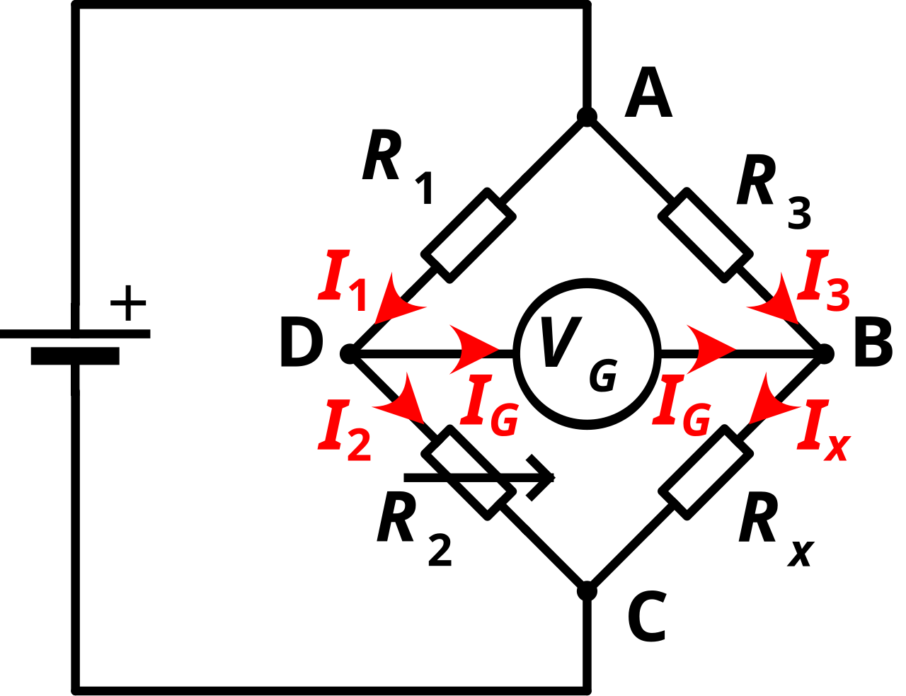

Using Wikipedia as example: the English Wheatstone bridge article contains this picture:
Assuming R1=R2=Rx and R3>R1 (tensile stress). Yes, I intentionally use R3 as the gage, as NI uses this one. Using Rx as the variable resistor instead would change the orientation of the measurement.
Using R3>R1, you will have current flowing in the direction of the arrows shown. Depending on which orientation you define for VG, this can be counted as positive or negative. Or, in other words: (D-B) is a positive voltage, (B-D) is a negative one.

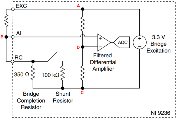

(B-D) is actually the orientation that NI uses. See e.g. Figure 1 in NI-9236's data sheet (I added letters to it according to the diagram above):
This diagram assumes the changing (left) arm of the bridge as the positive side for the differential amplifier, and the other one as the negative one. In case the resistors on the right side (around D) are equal, and the external resistor is >350 Ohm (tensile stress), then it's B<D, giving a negative reading.
(Note: I use this figure from the NI-9236 as it contains all the bridge's resistors in one diagram. Using the 9944/9945 with the 9237 gives the same result, but you need to merge two diagrams to understand why.)
So basically the reason for you seeing a positive measurement on compression is that there are two decisions to make when defining the "direction" of a Wheatstone bridge, and all options are arbitrary. NI decided to use the variable resistor close to the positive excitation voltage, and to define this arm of the bridge as the positive one.
