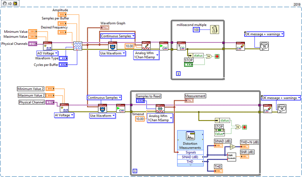

Are you referring to "Waveform Buffer Generation.vi"? That is a DAQmx example utility VI found at
<LabVIEW>\examples\DAQmx\_Utility\Waveform Buffer Generation.vi
Here is VI snippet of the top-level calling VI in LabVIEW 2019.
Doug

This thread was started many years ago. If you want to go through the thread, you can certainly pull the VIs to measure SNR from functionality that ships with LabVIEW Full. If you also have access to Sound and Vibration Toolkit, use the SV API to calculate SNR. There are ready-to-run examples, VI reference documentation, and conceptual materials that will help you confidently measure SNR, THD, THDN, SINAD, SFDR, Dynamic Range, and other audio/acoustic metrics.
