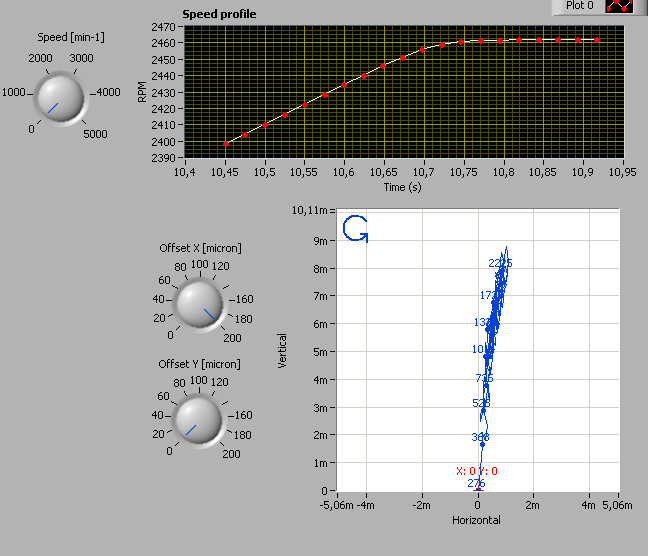

I try to simulate data for using the "Shaft Centerline ExpressVI" (NI Sound and Vibration). But my "Shaft Centerline Plot ExpressVI (sim).vi" doesn't work and I don't know why 😞
The ExpressVI shows no plot and the error massage "The input signal is empty." appears.

Speed profile is not likely sampled at the proper interval (at tachometer pulse positions). Please post back if you can verify sampling or need help converting speed profile to speed position info.
The speed waveform is also missing required attributes. Please refer to the generated code for the Tachometer Processing Express VI for how to attach all required attributes. (specifically OAT Convert Speed XY Graph to Waveform.vi)
What do you mean with "at the proper interval"? And how can I change it?
Do you mean the following attributes?
missing attributes?

I need the possibility to simulated shaft centerline plots on my desk. But not like the Example "Shaft Centerline Plot (Simulated).vi from the S&V-libary. I want to generate data by myself, with different speeds and offsets (shaft centerline motions), so that I can proof that the algorithm works correctly.
