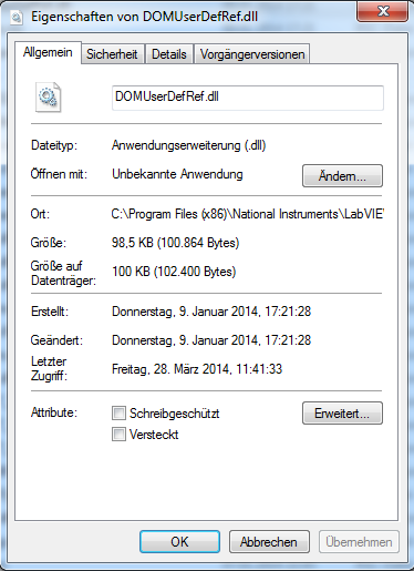

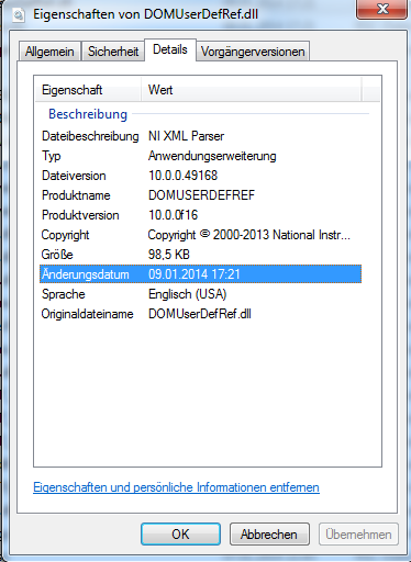

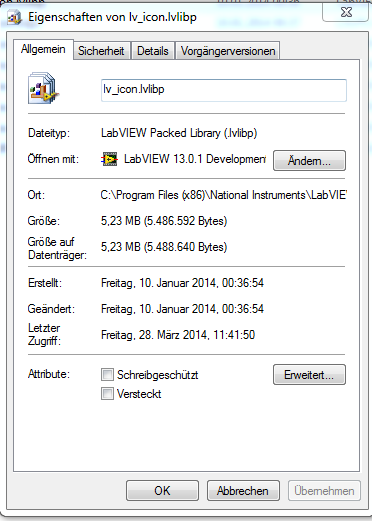

I just checked on a system running LabVIEW 2013 SP1 and did not have any issues. Let's check the file size and mod dates of your icon editor .lvlibp, and that DOM DLL...here's what they are on my system (Windows 7 32-bit, running LabVIEW 2013 SP1 32-bit...please tell me if you're running something different):
resource\plugins\lv_icon.lvlibp:
resource\DOMUserDefRef.dll (including "Details" page for version info as well):
Message 9 of 17
(12,873 Views)
Since, I am using a german windows, the dialogs are in german. But I think, the needed information is readable 😉
