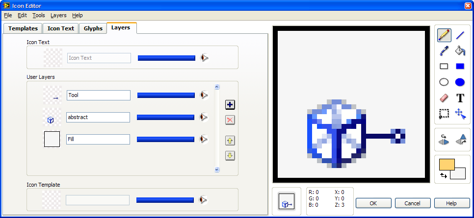

This has happened to me before LV2009 so it's not directly related to the new icon editor, but it's puzzling enough that I thought I'd post it here.  Occasionally I'll get a class with an icon banner that has an underlay that doesn't show up in the icon editor and I can't get rid of.  I don't have a good repro case, but it might be related to renaming the class.
Here I've changed the class banner color and slightly reduced the height.
But after applying the changes the part of the old banner still shows up in class member icons.
Yet when I edit the object icon the segment of blue banner doesn't show up.  I haven't found a way to 'fix' this problem.  When it happens I have to delete the class and create a new one.  Like I said this has happened to me before the new icon edit was released so I suspect it has more to do with the .lvclass file than the icon editor itself...
