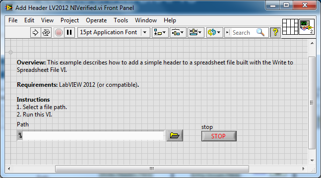

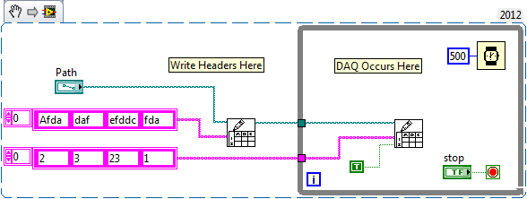

This example describes how to add a simple header to a spreadsheet file built with the Write to Spreadsheet File VI.
Description
Requirements
LabVIEW 2012 (or compatible)
Steps to Implement or Execute
  1. Select a file path.
  2. Run theVI.
