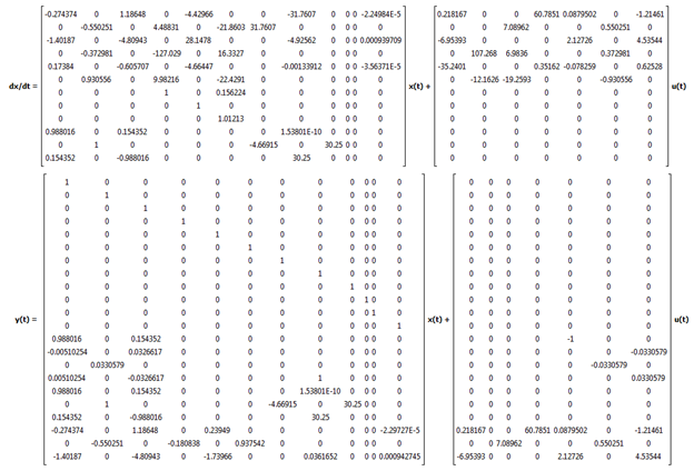

The state space obtained from FlatEarth is illustrated in Figure 3:
Figure 3: FlatEarth state space output to Labview
The state space variables, inputs, and outputs are defined in Table 4.
Figure 4: State Space Variable Definitions

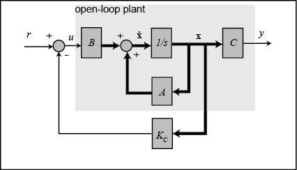

It is desirable to be able to apply proportional feedback control gains to the aileron, rudder, and elevator for aircraft testing. The figure below illustrates how the open-loop state space is wrapped by a proportional controller.
Figure 5: proportional feedback controller applied to state space [10]
With the addition of the proportional controller, the state space equation can then be written as: [10]

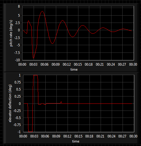

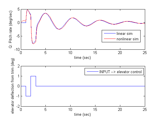

The longitudinal model was tested by injecting a doublet input on the elevator. More specifically, the elevator was deflected -1 degrees from trim for 1 second, then deflected +1 degrees from trim for 1 second, and then brought back to trim. The following figures show the FlatEarth output and Labview simulation output.
Figure 6: FlatEarth - pitch rate response to doublet elevator input
Figure 7: Labview simulation – pitch rate response to doublet elevator input
We see that the nonlinear FlatEarth, linear FlatEarth and Labview simulation results are all in acceptable agreement for pitch rate response to elevator commands. As such, the following can be concluded:
We also see that with an elevator deflection, the pitch rate dampens out and approaches a steady state value of zero. This corresponds to a dynamically stable aircraft in the longitudinal direction. This observation is in agreement with the flight qualities analysis.

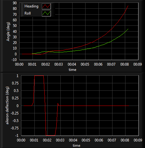

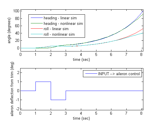

The lateral model was tested by injecting a doublet input on the aileron control. More specifically, the aileron was deflected +1 degrees from trim for 1 second, then deflected -1 degrees from trim for 1 second, and then brought back to trim. The following figures show the FlatEarth output and Labview simulation output.
Figure 8: FlatEarth - roll and yaw angle response to doublet aileron input
Figure 9: Labview simulation – roll and yaw angle response to doublet aileron input
We see that the nonlinear FlatEarth, linear FlatEarth and Labview simulation results are all in acceptable agreement for yaw angle and roll angle for approximately 7 seconds. After this time, the linearized solution begins to diverge from the nonlinear solution. This is to be expected as the linearized solution is only valid near trim conditions. At t=7 seconds, the aircraft is in a deep spiral dive - far from steady-level flight. We can conclude the following from these results:
We also see from these figures that the aircraft is unstable in the lateral direction. As the aircraft rolls and yaws in one direction, the angle grows over time. This is in agreement with the flight quality analysis which found the aircraft to be unstable in the spiral mode.
