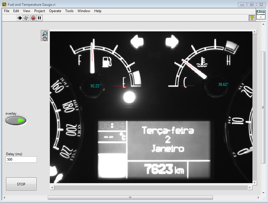

There are 3 examples (Fuel and Temperature gauge.vi, Speedometer Gauge.vi and Tachometer Gauge.vi) that load the respective gauge configuration file and take measurements. For an example of training programmatically see Gauge Training.vi.
Examples Palette:
Addons->Automotive Gauge Meter->Examples
Example 1 - Fuel and Temperature Gauge.vi

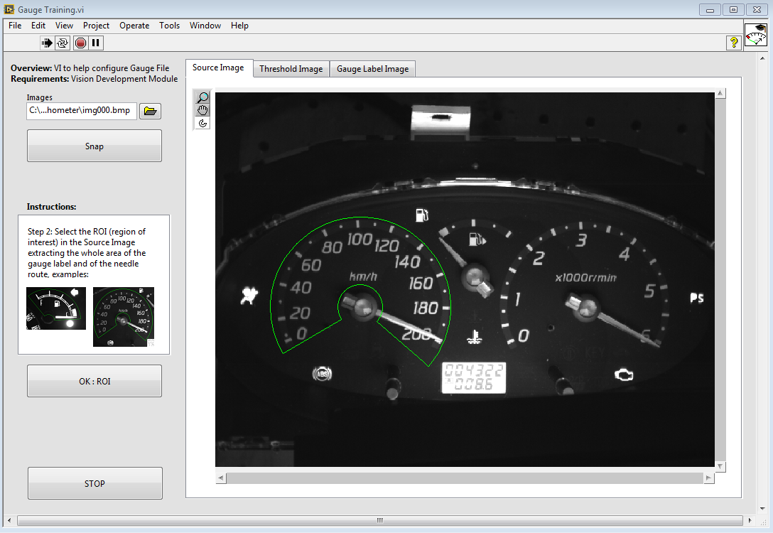

Step 2
Select the region of interest (ROI).

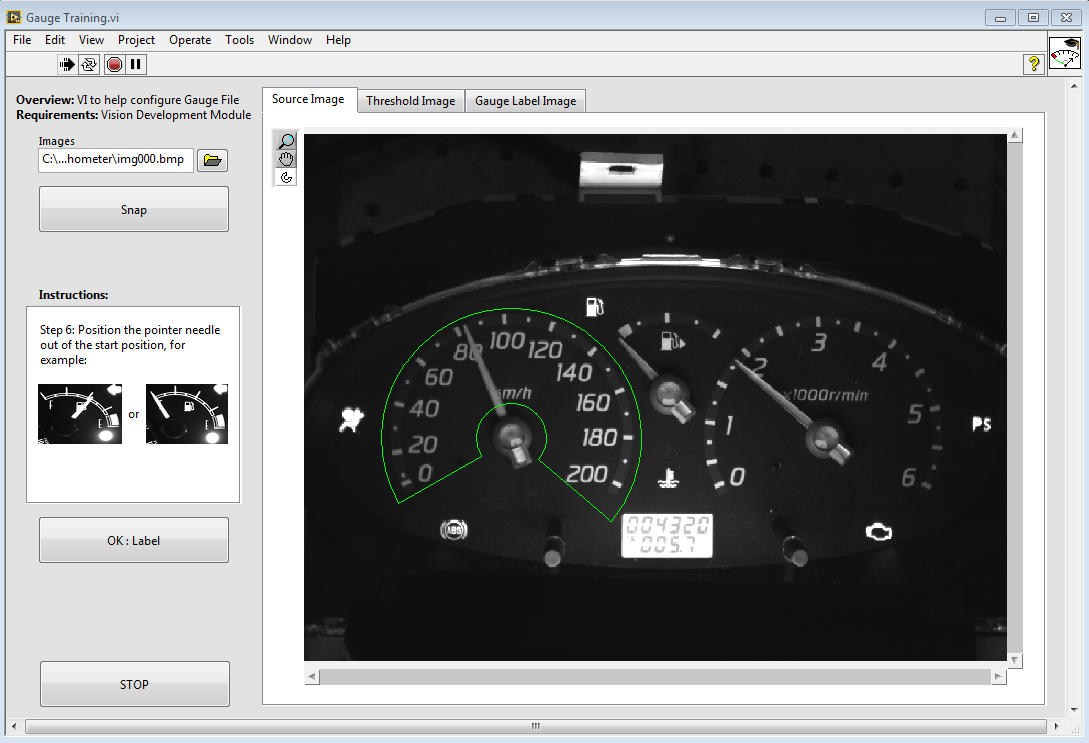

Step 6
Teaching the reference position.

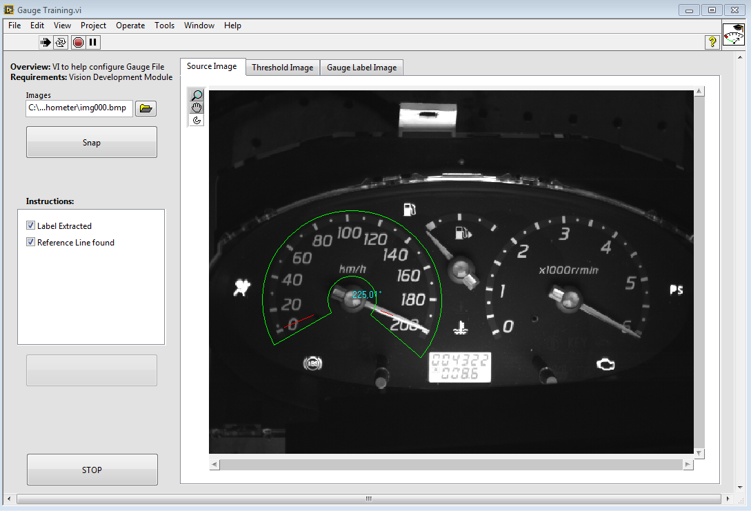

After that the gauge label will be extracted and it is able to save the gauge configuration file.
It is also possible to test the configuration file you have done by clicking on Snap buttom.
