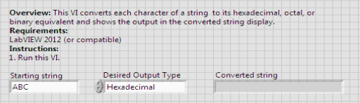

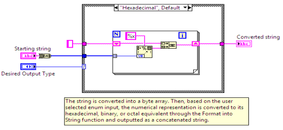

Overview:
This VI demonstrates string conversion by allowing the user to convert an input string to its equivalent hexadecimal, octal, or binary equivalent. It can be used stand-alone or as a subVI.
Description:
Requirements:
  • LabVIEW 2012 (or compatible)
Steps to Implement or Execute Code:
If using as a standalone VI:
  1. Open the VI.
  2. Enter the desired starting string
  3. Select the desired output type
  4. Run the VI.
  5. The output string will display in the "Converted string" field.
