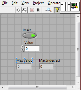

The attached VI and VBAI inspection show how to build an array using LabVIEW from VBAI and then read out a value from that array.
Note: The LabVIEW VI must be saved in 2010 to be compatible with VBAI 2011.
Instructions: Save the attached VI to your computer. Open each of the two Run LabVIEW VI steps in VBAI and navigate to Array in VBAI.vi. Open the simulate acquisition step and select a group of demo images and choose to cycle through folder of images. Run the VBAI inspection.
Screen Shots
