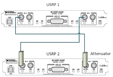

To re-calibrate the TDD switching delay, the TDD Switching Calibration test bench was created using two USRP RIO devices. The TDD switching delay (clock cycles) indicator shows the TDD switch delay in clock cycles as shown in Figure 16 for USRP RIO 120 MHz. Figure 17a shows the antenna connections based on the default setup in the MIMO Application Framework 1.1. You can select two USRP RIO devices from the rack of MIMO Prototyping System, where the transmitter USRP device should be the Master USRP in the BS rack. Figure 17b shows the required connections if you use cables. Add two attenuators if you have a direct connection.
Note: If the valley shown in Figure 17 is not detected, you can change the value of Amplitude Difference (dB) control to identify the valley.
Figure 16: TDD Switching Delay
(a) Using Antennas
(b) Using Cables with Attenuators
Figure 17: Required Setup to Measure the TDD Switching Delay
