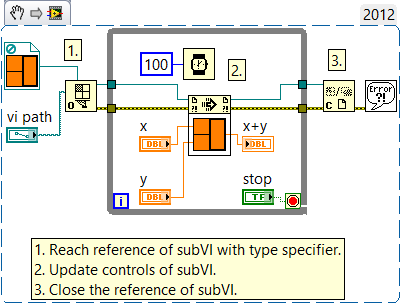

This VI shows how to call VI by reference using LabVIEW.
Description
You can use the Call By Reference Node function in LabVIEW to access the connector pane of your subVI.  There are clear instructions of how to create the required strictly typed VI reference in the LabVIEW Help file entry for this VI.  However, it is nice to be able to see, instead of reading, so here is a quick example of how to do it.
Requirements
Software:
  • LabVIEW 2012 (or compatible)
1. Select subVI part for calling it.
2. Run VI.
3. Observe the result of called VI on front panel.
