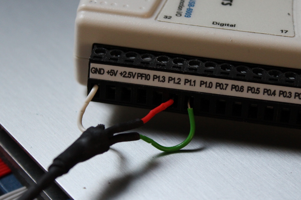

The first step is to find a 2.5mm headphone jack. This will fit inside the remote input of the camera. You may well have one lying around as several phone manufacturers use them for the input to the mobile phone hands-free kit.
Cut the wire. If there's a mic on it, cut the wire before the mic, then strip all of the wires down. You can be as neat as you like with this, but remember, adult supervision is strongly recommended.
Next, you need to reverse engineer this connection to find out which wires do what! I found that the one I disected had 4 wires as follows:
Naked: Unused.
White: Ground.
Green: Auto Focus (like half pressing the button on the camera).
Red: Shoot (like a full press on the camera button).
The two live wires were both active low. .jpg)
Wire these into two digital lines on your DAQ device, from the image, you can see how I wired mine into my 6009.
Downlad the attached code. It's all the source code, so you can edit as you wish. You may need to change some of the logic to make this work with your camera and headphone jack.
