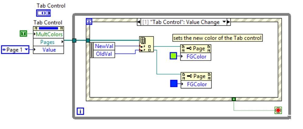

This VI allows you to programmatically change the color of tabs on a front panel tab control. It is ideal for high-lighting the selected tab
Description
In certain applications, the user wants to highlight the tab control, when pressed. This VI implements changing the color of Tab control programmatically, using Event Structure. Whenever a Tab control press, a value changed event occurs, and then changing the color to its new value (color)
Requirements
LabVIEW Full Development System 2012 or compatible
1.Run the VI
2.Switch between the Tab controls
3.Observe how each Tab changes its color
4.Press the stop button, to sop the VI
Additional Information or References
This VI is using Event Structure
VI Block Diagram
Change Color of Selected Tab LV2012 NI Verified BD.jpgChange Color of Selected Tab LV2012 NI Verified BD.jpg
