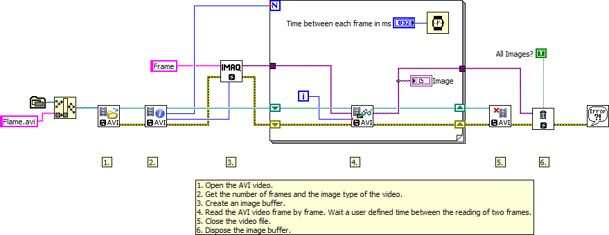

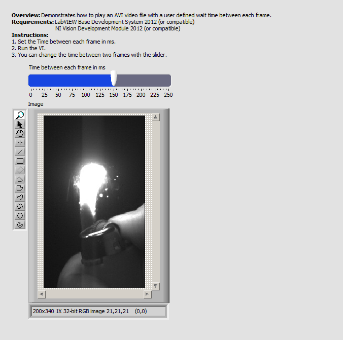

This example demonstrates how to play an AVI video file with a user defined wait time between each frame.
Description
If you want to replay an AVI video in LabVIEW, you need to control the frame rate of the video. The Vision Development Module (VDM) already provides the functions to open, read and close an AVI file. The frame rate has to be implemented with a wait time inside the loop which reads frame-by-frame from the AVI file.

  2. Open the VI and follow the instructions on the Front Panel
Additional Information or References
