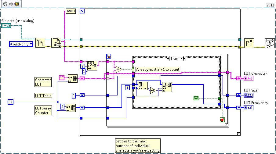

This VI is used to calcualte the frequency of characters (Strings, Numerics, Symbols) in a document
Description
Calcualte the frequency of characters (Strings, Numerics, Symbols) in a document, and return a look up table each individual character found along with the frequency at which they occur.
It could then use this to compress data (especially over RS-232) by using a binary table instead of sending 8-bits (1-byte) per ASCII character regardless of frequency, and converting this to a static LUT on an embedded device.

VI Snippet
