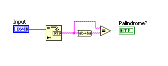

This VI takes an integer number from the user and determines if it is a palindrome or not.
Description
A palindrome is a number that is the same both forwards and backwards. The "Parse Number into 1D Array" community example was used to parse the input number into a 1D array of individual digits. Using this array, a comparison can be made with a reversed version of the array (Reverse 1D Array function), in order to determine if the number is identical both forwards and backwards. Since two arrays are being compared, the Compare Aggregates option of Comparison Mode was used for the Equal? function.

VI Block Diagram

Another way....
Convert to string, compare the reversed string to original version.

Yep, that is much simpler! Thanks!
