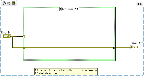

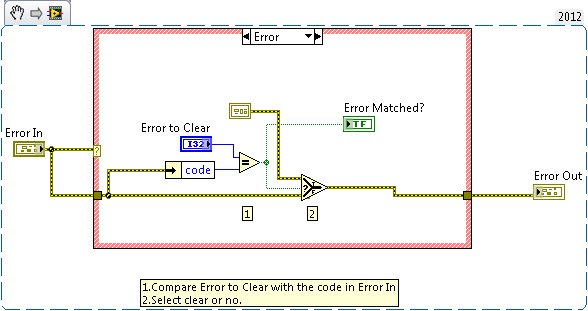

This example VI is designed to be able to be dropped into code and take up a smaller footprint.
Description
You can run the VI to get the calibration (scaling) coefficients of your specified device using DAQmx property nodes.
Requirements
  • LabVIEW 2012 (or compatible)
  1. Input error in Error to Clear.
  2. Run the VI.
