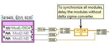

This example shows how you can compensate for different group delays with C series modules in LabVIEW FPGA on NI cRIO plattform.
Description
Group delay is a trait inherent to delta sigma converters. All of the NI C Series modules which use a delta sigma converter have a specification for group delay in the
User Manual. Group delays are typically different for each ADC and can vary depending on the sampling rates. A method to compensate for these differences in group
delays is to use a simple feedback node which delays a signal by a fractional number of samples.
In this example a Digital Output create a pulse. A Digital Input, a Analog Input with SAR ADC and a Analog Input with Delta-Sigma ADC measure the pulse.
NI 9401 DO 0 --> NI 9401 DI 4
--> NI 9215 AI 0
--> NI 9229 AI 0
In the chart you can see that the feedback node delays the signals of the channels without a Sigma-Delta ADCs and the signals in the graph are now synchronous.
Please check also out the Input Delay Calculator (NI 9229).vi on My Computer in projecct.

Thanks for your help. I came to a similar solution, ie, using the feedback node and a counter. I had to sync a SAR with 3 sigma-deltas that were running at a different sampling rate. For the SAR I initially wanted it to run at 1MSa/s, while the sigma-delta modules were running at 51.2kSa/s. Eventually, I got the sigma-delta modules running at 50kSa/s and the SAR at 800kSa/s. By running the SAR at 800kSa/s I was able to use the master clock of the sigma-delta modules(12.8MHz) to trigger acquisition on the SAR module. There was too much drift between the FPGA clock and the sigma-delta master clock.
Thanks again.
