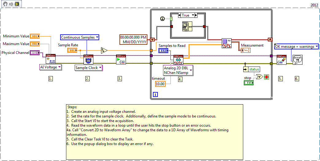

Acquire Data in 2D Format.
Take a time stamp at the first acquisition.
Take each channel of the data and use the timestamp and t0 (inverse of the rate) to create a waveform.
Use a for loop to auto-index the data and build an array.

Block Diagram of Cont Acq&Graph Voltage-Int Clk Make Waveform from 2D
Block Diagram of Convert 2D to Waveform Array
