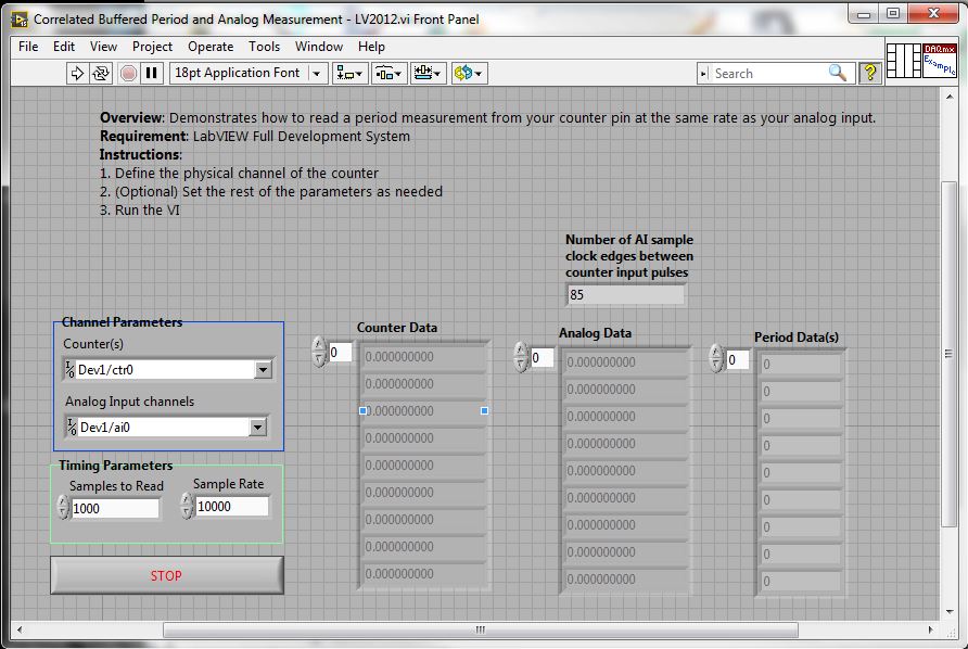

This example allows you to read a period measurement from your counter pin at the same rate as your analog input.
Description:

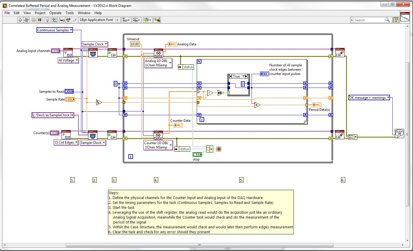

As described, the VI would read a period measurement and match the rate of the usage of the analog input. It will hold the previous period value (stale data) until the next period is completed.  This will get around the error,  "The requested Samples have not yet been acquired", when trying to run a buffered period measurement faster than the frequency of the signal of interest.
Basically, this VI allows you to perform a buffered period measurement at whatever rate you would like, and the value returned will be old data until the new period has completed.
This allows you to log data for period 1 to 1 with the analog input data.
Things to keep in mind:
  • The data might be stale/old.
  • The counter is correlated to the analog sample clock.
  • The analog sample rate determines the period resolution/accuracy.
  • If the sample rate gets to be high enough, it could be necessary to use producer/consumer architecture to prevent buffer overflow.

  1. Configure the following parameters: Counter channel, Analog input channel, the sampling rate, and samples to read for    your application
  2. Run the VI
  3. (Optional) Turn on the Highlight Execution to see the flow of the VI
