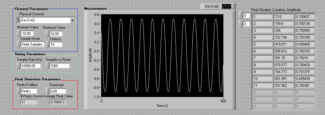

This Example code takes a finite amount of data at an adjustable rate and duration.
Description
This Example code takes a finite amount of data at an adjustable rate and duration. It then processes the data to find the Location and Amplitude of each peak and an average value for all of the peaks. The threshold for what is a "peak" is also adjustable through the front panel controls.

  1. Configure the parameter for the right channel and device
  2. Connect your hardware appropriately
  3. Run the VI
